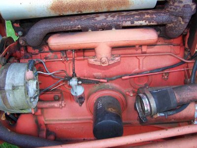

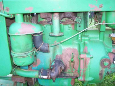

Put the batteries back on the Ford 851 and John Deere 40 after charging them. Both batteries were dead when I tried starting them a couple of weeks ago. They both fired up but but were sputtering and surging a little. I could see a little water in the sediment bowls and suspected the fuel bowls has some too. Pulled both carbs and brought them to the shop. Opened them up and found both had a little water in them. Other than that they looked pretty clean so I just shot some carb cleaner thru them and will put them back together and install them. Hopefully thats all they need.

Put the carbs back on the Ford 851 and John Deere 40 and got them fired up and running good. The filed the points in the John Deere B and started it up. 3 more tractors ready to go.
