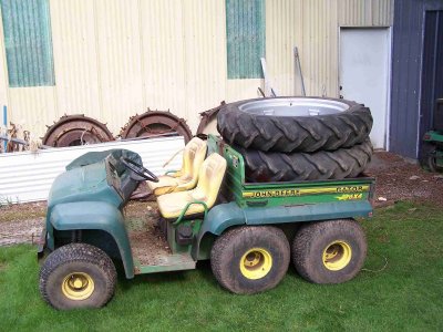

Looked over the old tubes for these wheels and found spots on both that are splitting. Bought a pair of new tubes yesterday and mounted the tires up today. Loaded them in the Gator to transport to the farm where the Farmall C is located. Not sure if I will get them bolted on the tractor today but by tomorrow for sure. Need to move the tractor so I can get a load of bedding for the cows.
I would be interested in seeing what you go through to mount tires on rims, CJet! Do you use another tractor to mount the wheel/tire to the tractor? Looks like some heavy work for one guy.
These larger tires are usually pretty easy to mount. I use some tire mounting compound which helps the bead slide on. The tire/wheel weight isn't to bad on these. Just use a bottle jack to lift the tractor up to where I can get one bolt at the top and then keep jacking until the bottom slides in place. Then just wiggle things around until all of the bolts are in and tighten it down. I have the tire back on the tractor but forgot my camera so I will get some pics tomorrow. Here is a pic of the mounting compound.

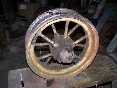

Started a repair on a front wheel for the 1942 John Deere BO. It was thin enough that I decided to cut out the rusted through area and found a donor wheel to cut patch pieces out of. Got the pieces cut out of both wheels and just need to make a final trim to fit before welding.

I find it pretty unique that the hub, spokes and wheel are all assembled as one unit..
Don't imagine you find them just anywhere.
It would be interesting to see how they do it. There are a few places where you can send your wheels in and they will put new rims on them but it'll cost ya. This wheel is whats called a cut-off where they took a full steel wheel, cut the rim off, and welded on a rubber tire rim. Our 1937 John Deere BO has a set of round spoke wheel that are the original rubber style. I need to repair a front wheel for that tractor also.
Finished fitting and welded the patch in the wheel. The donor wheel shape has a pretty close match to the original wheel so it wasn't to much work making it fit close enough. Need to check the rest of the wheel for thin spots that need weld but after that It will just need a good sandblasting.
