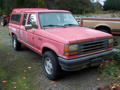

Body is in good shape. Never used to get salt on the roads in winter around here. Now they put some on but I am not driving in it every day. The red paint is really faded. Guess I need to talk with my painter. It needs a new windshield and the sagging headliner fabric glued back down to the molded backing. Already bought the new clutch and hope to get it in this winter once I clear a spot for it in the shop.

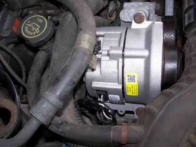

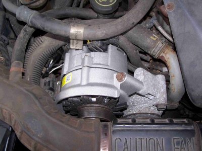

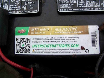

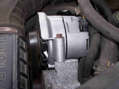

Installed the new alternator. Doesn't look like that pigtail plug can be removed. Cut the original plug off then crimped, soldered, and some heat shrink tubing that was supplied with the alternator. Fired up and charges like it should but so did the other one. Not seeing a big draw anymore so we will see in a few weeks if this fixed the problem. A few pics of it installed along with the several month old battery and one of how the truck looks right now with the faded paint,dirt, and some green algae.

Don't look like it would take too much work to polish off the oxidation on that little truck, CJet!
Hope the alternator does the trick!
I could buff it up one more time but with the rock chips and decal edges beginning to get rough it would probably be best to paint it. I think it only has one spot of rust at the roof, drip rail, and front pillar seam. Not too bad for spending its life outside.
No matter what it needed the alternator with the brushes and slip rings being worn out. Just buying parts to fix the old one would have cost quite a bit and I wouldn't have the warranty either. Plus the time I would have spent on it. At the pace my projects go I could have spent years rebuilding the alternator. ;)
