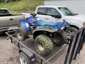

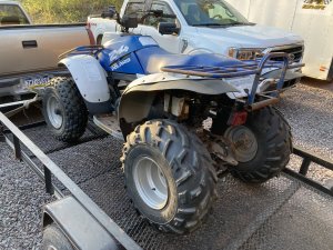

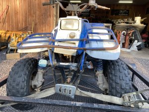

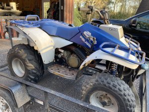

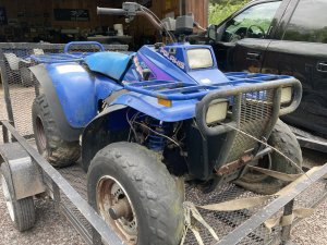

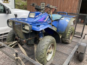

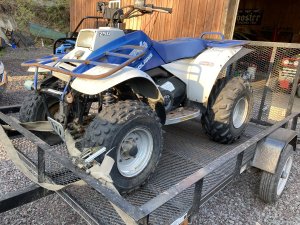

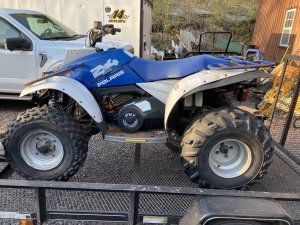

I picked up the first one tonight, possibly going back for the second one tomorrow. They came from a friend of mine and my dads. I got two snowmobiles from him last year, and he mentioned that I could have these too.
The first one is a Polaris 250, 2 stroke, 2 wheel drive. Probably the nicer of the two. He said it was sitting for a year and a half, but I think it was longer. The gas is nasty, and the brake and throttle levers are both stuck. Pull start rope is broke, but it also has electric start. It will need front tires, or at least tubes. It doesn’t look too bad otherwise besides some damage on the front. His kid was riding it and the throttle stuck, he bailed and it hit the stone wall. He said my dad rebuilt the motor in it for him at one time, but my dad doesn’t remember that.

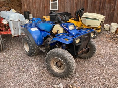

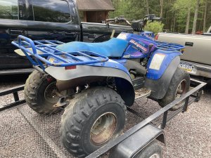

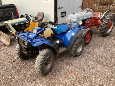

And here’s the other one. Also a Polaris, 425 Magnum. 4 stroke, liquid cooled, 4x4. He has a plow for it. I’ll post more on that when I get it home.
Not sure what I’m going to do with them. I’ll probably get the 250 running and sell it. If the other one is decent, I may keep it. Or sell them both and buy one nicer one.
That’s a couple of nice projects. That 250 would be a good flip to someone’s kid or grandchild if you can keep your costs down. The other one would be nice to have around to take a ride or do some work. I haven’t rode mine in awhile we have been infested with ticks this year.
That’s what I was thinking, and I already know someone that might be interested. He’s been bugging me to sell him my Kawasaki Bayou for his kid. I haven’t rode it for a few years, but I don’t think I’m ready to sell it yet.

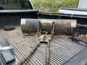

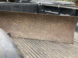

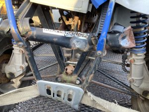

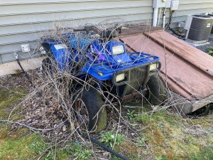

I just went and got number 2. He said it was sitting about 3 years, but ran good when parked. The only issue he pointed out is that the muffler is rotted off. The plastics are all in decent shape. It needs tires, but I have a good set here if they are the same size. Obviously it will need the fuel system cleaned and oil changed. The plow could use paint, but looks like it’s in pretty good shape. I have to cut grass first, then I’ll hit it with the pressure washer and get all the algae off it before I bring it in the garage. I’ll probably try to get this one running first.

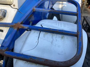

It’s been a while, but I finally have an update on the 425 Magnum. When I first got it, I went through the fuel system and got it running. A new Amazon carburetor, a fuel pump, filter, and new lines. After that I started working on the brakes. The master cylinder was locked up along with the calipers. I got a new master cylinder, and front calipers. I couldn’t find a new rear caliper, but I did find a rebuild kit for it. I changed the front brakes and master cylinder, and took off the rear caliper to rebuild it. Then I stopped working on it for way too long.
About a month ago I decided to start working on it again, because I want to use it for plowing snow this winter. I pulled it out of the corner and cleaned it off, and put some fresh gas in and it started right up. I was expecting the carburetor to need to be cleaned after almost 2 years. I got the rear caliper rebuilt and put back on, then filled and bled the system. I don’t think the rear brake is working, but the front ones work great. I may have put something together wrong there, but it stops good enough with just the fronts so I’m not going to worry about that right now.
Now that it runs and has brakes I was able to take it for a ride. I had some issues with the carb flooding at first, but I set the float a little lower and that seemed to fix it. If it starts giving me trouble again I will probably look for a used factory carb to rebuild. The one that was on it is junk. I have been riding it bit, so far it runs and drives great, but it runs hot. I don’t think the fan is working, so I need to figure out why. It may be rusted up from sitting. That doesn’t look like it is going to be fun to get out. The tires that were on it are bald and only hold air for a couple minutes, so for now I borrowed the rears off the other quad and the fronts off my mom’s quad. She doesn’t ride it much anyway. I will be getting a set of tires for it soon. Not sure if I want to spend the money on new ones right now or just find used ones. All the light bulbs were burned out, apparently that’s common on these if you run them with a dead battery. I changed them all but the dash warning lights, since I had to order them, and they just came in today. It needs a rear shock, and the pull start rope broke (it does have electric start that works), but other than that, I don’t see any other issues. It mostly just needs cosmetic stuff like a new seat cover, and maybe paint the racks, handlebars, and bumper. I still have to put some of the plastics back on yet, but I want to ride it more make sure there’s no issues first.
I guess I didn’t take any pictures while I was working on it, so here are two from after it’s first test ride.
