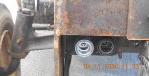

Well the couplers I bought are not going to work here. Male end fits JD, Female won't work.

I got to thinking over night and I may be able to use the new connectors. They will be pointing straight down, but that would work for now. I'll see if my idea works today!
Went to TSC to find some fittings and they had 1 new connector. Got it attached in the hard spot, I'll find another soon. Used an old one for the other side, it leaks some. Attached everything and checked the lift. I have -1" to +8" with the tractor on 1" boards. That'll work for me! Took it all apart to weld the cylinder mount, then gave it a coat of Rust Reformer for now.
