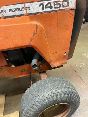

Thought I should revive this year dead thread as I got to work on the MF1450 today. Some of the previous discussion was about a broken spool valve cap. Until it got repaired somehow, the spool valve cover Daniel sent me would not fit. There was also a big help from our late friend KennyP as he sent me the correct lever for one of the lifts. Between Daniel and Kenny I couldn't have done this.
To review, this steel bracket was holding on the broken float valve cap.
The broken cap without that bracket holding it together.
This cover Daniel sent would not fit because of that and a wrong lever on the spool valve.
Kenny sent me this lever assembly which was the correct one.

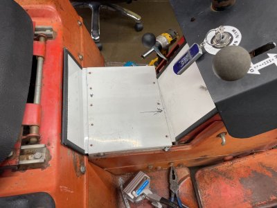

Finally today I did the repair on that broken cap, but plumbers tape I have just seemed too wide. Some of you guys probably remember back in the 70's and 80's buying tape decks for your cars. They always came with a strap to support the back of the player. It is about 1/4" narrower than plumbers tape and this particular piece was EXACTLY the right length! Must be living right for that to happen---LOL! I could make 3 of the bends in the sheet metal brake then used a hand brake for the last one.
Put the new strap over the broken cap and screwed it into place.
This tractor had been in some kind of a bad wreck like falling out of the back of a pickup or from a moving trailer at one time before I got it. Pretty much everything is bent and tweaked in one way or another. The two speed lever had to be bent into more of an angle to have full swing and also work in the slot of the cover. Went ahead and mounted the cover and it was a bit of a battle to get the bolts into also. The fender pan is far from straight but got it in! Probably someone with a restorable tractor should have the cover rather than this beat to hell one! I appreciate it though, Daniel!
I have no attachments for the center lift or rear PTO yet but maybe someday. Definitely want to try to mount the blade from the MF12G to it some time. That would use the center lift with the float spool.

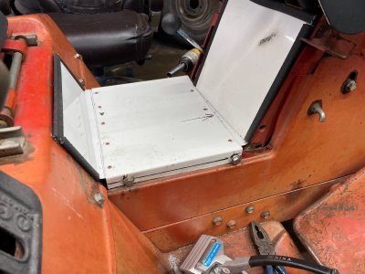

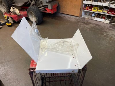

One of these days I will bend up an 1/8" plate aluminum tunnel cover like I had to do with the dash. Probably would hurt to get a shirt tail or something like that caught in the drive shaft!
