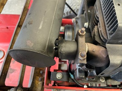

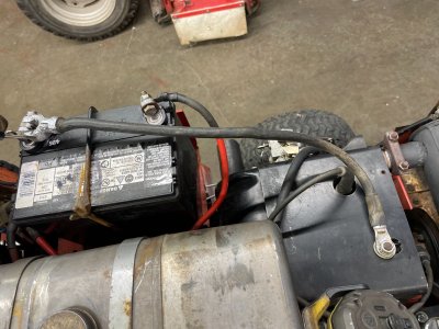

Got the Cub home but still on the trailer. Took the engine cover off, then the starter. Starter still won't turn. Used a small pry bar on the flywheel gears against the ignition coil mounting post on both sides and it would not budge. Locked up solid. Courage Kohler engine. Think I will unload it in the machine shed for the winter and see what shakes out next spring. Would have to swap hood and engine as there is some air intake moldings that have to go with a Briggs engine. Might get another engine and use Carolyn's as a donkey around here and put that little Bolens 775 in storage.
