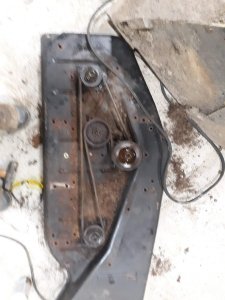

I finally got a chance to tear my new deck down to restore it. During inspection, I didn't see any holes in it, but after tearing it down, I found 2 spots with pin holes, no big deal, just a bit of mig welding and JB weld to pretty it up.
He really took care of the spindle bearings, they spin freely and no play in them, so just a cleaning and a coat of paint. I looked the blades over, and they are in great shape, after I took them off, I wire wheeled them, sharpened them, balanced them, and put a coat of rust reformer on them.
I will replace the tensioner pulley and spring since it's apart, the spring is pretty weak feeling and the pulley has some play in it.

Here is a picture of the deck once I got the upper cover off...
