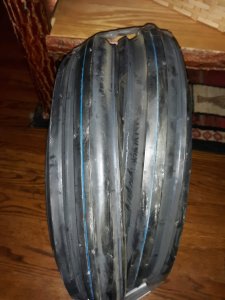

The new tires look great if those are the oem rims, the width will make them look perfect on there. Oh, are you planning on tubing them? They will work without, but the fronts especially will be more reliable with.

Front tires will be tubed, I'm trying to go Tubeless on the rears to get more fluid in them. Depending on how well it steers in the snow with the plow on, I may fill the fronts too, which will gain me about a whopping 8 lbs. per wheel, lol.

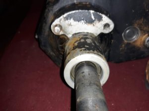

A welder that owes my buddy a favor thinks he can get those busted bolts out of my transaxle by running a rod deep into the bolt, welding a nut on the stud, quenching it, then he says they should back out pretty easy. Gonna try it tomorrow...Broken bolts in question. Is say they have 3/8" shank sticking out.
We didn't succeed in removing them, bolts are way too soft. At least I shouldn't have a hard time drilling them out, lol. Now I have to level them off with a grinder, try to center punch them, and drill straight pilot holes. I may get an estimate from a machine shop.
Those bolts are really soft. Working them back and forth, we couldn't get one to move. I'm glad I got at least one out to know what depth to stop at, I'm not sure how much material is behind them before I poke through the housing.

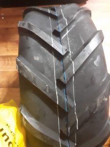

Looked at my free tractor a bit, the rear rims are the same, so I'll eventually wire wheel them down, paint them, buy another pair of Deestone ags for them, load them and put them on if it doesn't plow well. I don't mind doing that except for buying another set of tire chains. I'm gonna try the 2 link spaced v-bars I have, but I'm worried about using them on ag treads. I saw the duo and diamond style are for deep treads, starting at $125 per set. Not sure if I'll need duals or not, but it sure would look cool, lol. With a wider stance, I could possibly reduce some of the weed eating I do now, which is about 3 hours to do my main bank.
