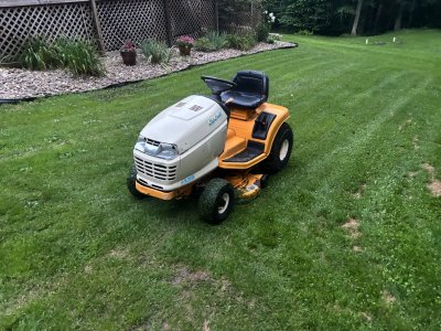

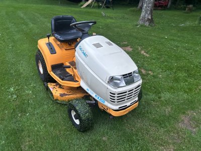

I got my 2135 running over the weekend, I have a guy who wants to buy it. I got it a couple years ago from my aunt, and I intended to fix it up and sell it, but I never really did anything with it. It had an electrical issue and wouldn’t start. I thought the starter was bad, but it just ended up being a dirty connection on the key switch. I put a battery in it, drained the old gas out, cleaned the carburetor, replaced the fuel lines and cleaned a mouse nest out of the engine tins, and it started. I cut grass with it yesterday, it ran good. The mower deck could use some work, it keeps throwing the PTO belt off, but the guy whose buying it has another one of these tractors for parts, so I will leave that for him to fix. I just have to clean it up a little bit, and it will be ready to go.

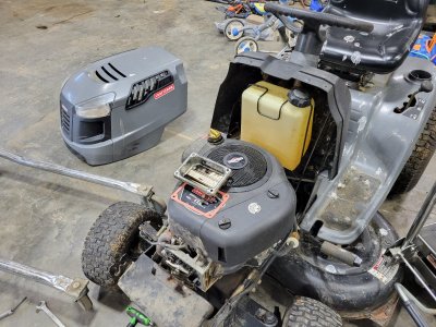

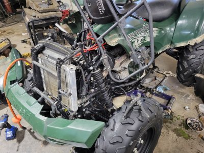

17.5 Briggs I thought just needed a valve adjustment due to kick back on starter, but turned out the automatic compression release on camshaft is broken. Not sure yet if owner wants to foot bill to fix. Then there's this Kawasaki Brute Force 750 4 wheeler...the hardest to work on EVER! I had to remove front rack and all front fender just to get to the radiator cap! NO removable cover for access! Everything requires "Brute Force" to get to anything! Still can't even see rear spark plug!

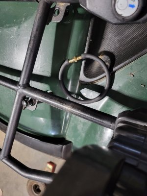

The 750 Kawasaki needs a hole cut where I laid a loop of fuel line in Pic. Sent to owner to see if I get the go ahead. Totally stupid that it has zero access to radiator cap! Even after removing rack and fenders, the radiator cap still can't be accessed until you remove yet another plastic cover! From under fender you can't even get a peek at the cap!

Curious to how you determined the compression release was broke..?

Sounds like there is a Kawasaki engineer that needs to be hauled out to the nearest tree and lynched, Daniel! What the hell are they thinking?

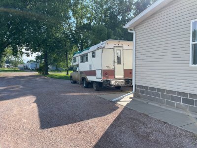

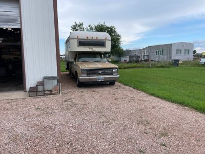

Got the tailgate and box pocket tie downs pulled off the '83 C-10. Raised up the old monstrosity cabover camper and backed the C-10 under it far as it would go. The rear bumper don't exactly jive with the camper mounts.
Got it secured good enough to move and put it in front of the house. It will be going over to that house across the street and unloaded beside that little garage. For some reason the old disabled Veteran that lives over there wants it. He gave me some cash a couple weeks ago to hold it for him. Will talk to him tomorrow about where he wants it and hopefully unload it.

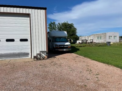

Put our new to us little motorhome where the camper was sitting.
I hadn't seen any wasps all year but managed to scare up a bunch in one of the front jack legs of the old cabover! I had a can of penetrating spray out there already to tame them down! Everything was tight and stubborn to get the thing raised up. Didn't get stung at least.
It will be nice having something that is easily movable beside the shop to have access to the back yard rather than a giant roadblock!

After adjusting valves to proper clearance, as you turn engine just before TDC, the intake valve should open just a tiny bit to drop compression enough so it can spin over. You have watch the valve closely to even see it, as it's very slight. Once engine fires the centripical force causes a small weight on the compression release to pull in the little rod that bumps the lifter to relieve compression so engine then has full compression. Usually when the compression release stops working it's because the little rod snaps off. It's less than 1/8" thick and over 1/2" long...maybe 3/4. If owner chooses to have me put in new camshaft I will post a pic of the failed part.
