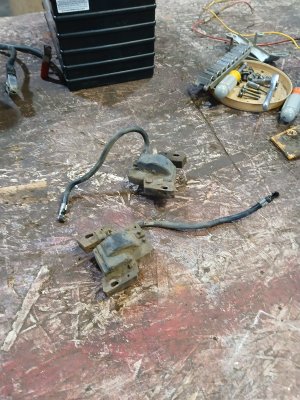

Pulled the wood splitter up to the shop to get running to hopefully sell. Been parked outside with tub over the engine since the building it was in disappeared in the tornado over a year ago. Pulled the shroud off that old cast iron 10 hp B&S and as expected and mouse hotel. Bot it all blew out and cleaned up found they had been chewing some on the plug wire so taped that up good. Then noticed there are two bare wires from the magneto twisted together and a small loop at the end. Have no idea where they were attached but am sure they go to ground. No spark when I pull it over, plug looks real good so will have to get that solved first. Got the flywheel cleaned up and the ends of the plates on the mag. Back was done for the day so that is where I left it. This is a rope start engine, no charging, lights or any of that stuff. Any other suggestions for those two bare wires let me know. Other two wires are to the plug and points. Ground the sparkplug to kill the engine. Real old school.
Finally found the info I needed. The two wires are normally not used in this setup. The ignition coil is bad, open between the plug wire and the coil base. Rusted up pretty bad so not surprising. New one should be here Saturday. Put the new points, condenser and lug on it this morning. Fun trying to keep the .10 setting right as it changes every time you tighten the lock nut on that adjusting screw. Have to set the points at about .12-.13, then tighten the nut and it bring them back to .10"

Finished up getting the old wood splitter ready to sell this morning. Put the points, condenser and plug on it the other day. New ignition coil came Saturday so put it on this morning. Started and ran on the first pull. Those old Briggs are hard to beat if you get the points and coil gapped right.
