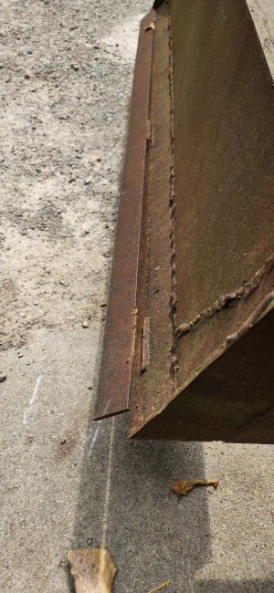

Finished up the door install in the side of the shipping container. Son-in-law was up yesterday morning and finished cutting the hole out. Got the trim on the frame and the frame in the hole. Then hung the door and anchored the frame to the container temporarily. I will work for a long time this way but want to weld the angles to the container. Used 6' pieces of 1"x3/16 angle iron vertical screwed to the 2x4 door frame with the angle iron tight against the container wall. This morning I put the stop on and put the keeper in for the door. Put a bathroom window from a trailer house in the end so with it open and the walk in door open will get a breeze through if there is any. Will get some pictures in the morning. Was cool this morning so started about 7:15 to get the walk in door done before it got hot. Some where along the line of moving the wood shop to the container I lost track of the charger for the Makita battery sticks. Cannot located it any where, even looked in the burn pile. Have a new one on the way - be here tomorrow so the old one will show up in the not to distant future.
