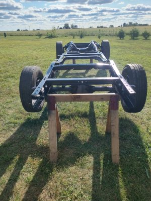

Today I got my truck frame painted. It's been at my son's house since I had it blasted and primed, been wanting to get out there and do this for at least a month. Either we have had something else going, or it was too windy, something.
I painted with an HVLP type of gun for the first time.
I know I didn't have the gun set right, but it worked. I was a little Leary about it going in but it worked. Came out good.
I ran the paint that Sherwin Williams recommended over the particular primer that was used, and damn it was expensive.
Off the street it's over $500 a gallon with the quart of hardener. I got it for a lil over half price thanks to a neighbor who uses to work for them.
I wish I'd of had him get the recommended thinner for me at the same time.
I went and got that, it's "only" $60/gallon. I bought 2, used less than a half of one, wonder if they'll take the 2nd unused gallon back...
That paint went a long way. Don't know if it's because of being "high solids" or if it was the type of paint gun I used
I mixed just a quart in a gallon ish plastic bucket, to start with, added the 8 oz of "part B" and the recommended 15% by volume of thinner. So 46 oz total of paint, when added together. I went and went and went some more before I ran out. I almost had enough with that, I mixed another 8 oz of paint plus part B and thinner and that got me done. I sure wouldn't have thought that.
I'm glad I didn't just mix up the whole gallon to start off with or the remainder would be scrap right now.
I did miss one small spot that got overlooked, (the bottom of 1 cross member) I'll get that once it dries and I get it home
I set it on 2 sawhorses (surprised they held)! My son was able to barely pick up one end at a time for me to set a horse under, with his Kubota
He's on 2+ acres, has an acre on each side of the house.
I set it in the middle of one of those acres and had plenty of room around me to allow for any over spray/ of which I had surprisingly little.

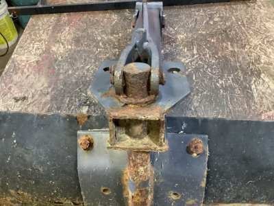

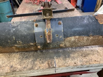

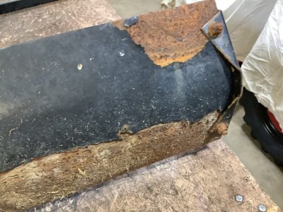

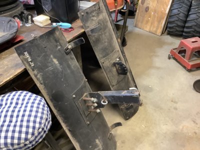

The owner of the local mower shop stopped by and left me a box blade. During a pickup/delivery he snagged a freebie box blade. The P.O. had left it sitting out for a few years on it’s back. The blade was corroded and the pivot pin was froze in place. He didn’t have time to fix it and offered o pay me to do it.
Some liquid wrench and a BFH finally got it apart.

After a lot of cleaning and paint it went back together.
This is going to his 14 year old son so I didn’t charge him anything.

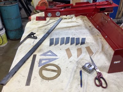

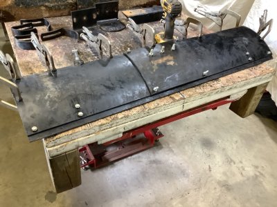

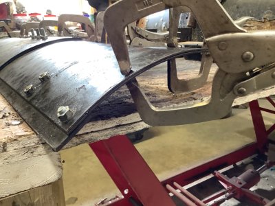

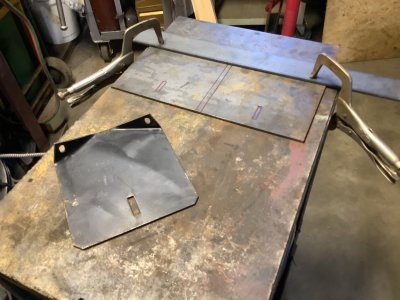

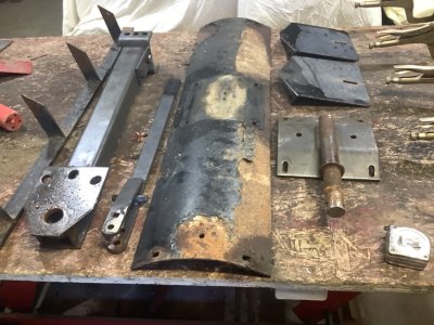

While I had the box blade apart i made templates to replicate it. I took two Craftsman snow blades, cut down the height and welded them together. Doubled up the backing plate also. Made up end plates from thicker material, and the main beam from some thick wall square tubing. Rigged up a pivot handle from scrap . Made a pivot pin from a solid dumbell handle. Made a 1/2” thick ripper bar with 1/4” thick teeth. Ct out several templates to find the angles I wanted for the teeth.
Got most of it done yesterday. Made the ripper bar today. Waiting on the paint to dry. Final assembly tomorrow.

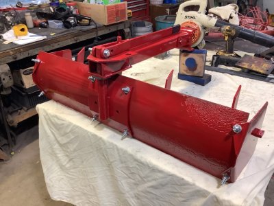

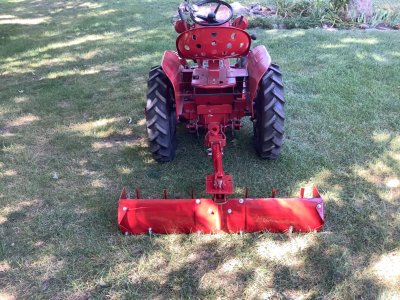

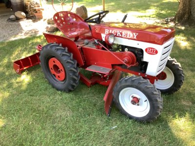

Put it together this morning. Hooked on the back of my 1277 with the belly blade.
Next thing will be to get a snow blade ready.
