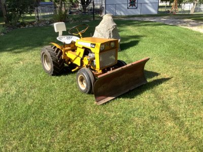

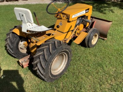

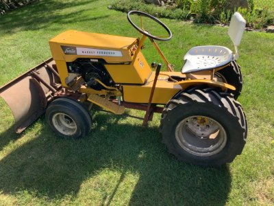

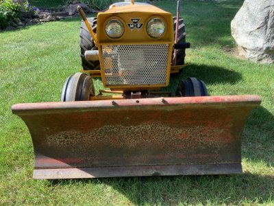

Thought I should finish up on posting this project before I forgot all together.

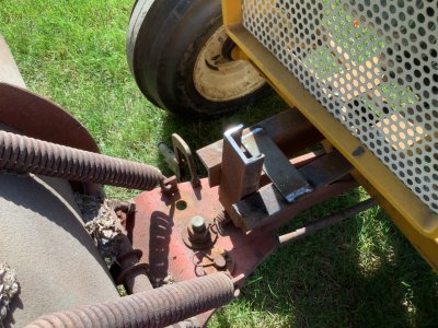

Replaced the rear mountimg plate with a piece of c channel. Made up a set of brackets off the front of the tractor to keep the blade aligned. Cut off the excess of the vertical c channel and it doesn’t interfere with opening the hood. Even with the blade up. This blade is heavy to lift. So I installed helper springs under the frame.
Also removed the 6-12 bar tread rear tires and the 3.50-6 front tri ribs. Installed 23x10.50 tru-powers on the rear and 16x6.50-tri-ribs on the front.
