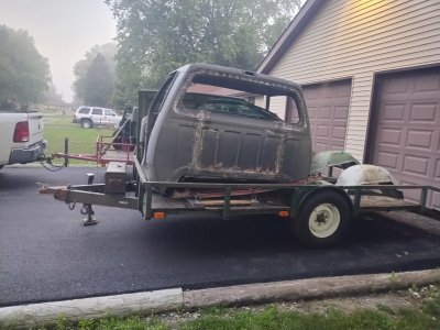

Then came home and loaded the cab and hood on my trailer and dug for other parts that need to go too like inner wheel wells etc..... still have one I cant find. I left the ones I have in storage because I knew I have 2 sets here, wound up the only driver side one I can find here isnt quite as "nice" as I thought so had to make a run back to the barn for one of the ones I left yesterday "knowing" what I had here.... I don't yet have room here for the leftovers still out at the barn/ but Im working on that.
The bad part is the other inner wheel well thats MIA has the only battery tray I know of among my stash still bolted to it... (weird/ its a pretty big piece not to be in plain sight, at least a corner of under other stuff) Taking stock of what additional parts I have I realized I have a BUNCH of passenger side sheet metal but "just enough" driver side sheet metal.... I dunno why I don't have the same number of doors and fenders for each side.... got a couple of Phillips screws to grind slots for a flathead screwdriver so I can get the handle out of one of my tailgates and get that off before it goes for blast... haven't I said before that I HATE PHILLIPS SCREWS!? taking 2 of a few parts for blast "just in case".... cheaper to get them done as a "bundle" than having to go back with just 1 part by itself later....

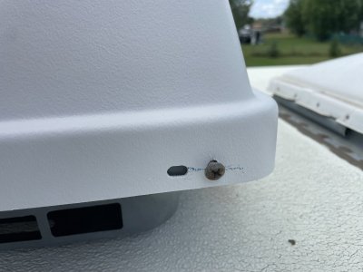

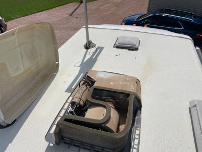

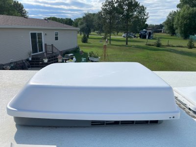

I got the new A/C cover on the motorhome today. Although I was 99% sure I ordered the right one I still had a small amount of doubt. It fit but one hole was punched about 1/2" off. Drilled it and they all lined up fine.
It seals tight against the foam inside so it should be good to go.

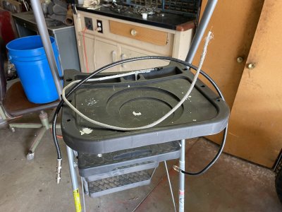

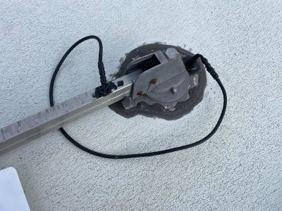

The UHF TV antenna coax is junk. I did a temporary splice, but I will have to buy some fittings and try to replace it from inside the crank assembly out to the head. Seems to work ok for now but it won't last long. Hopefully it will last for out trip to Denver next week if I don't get time to fix it this week.

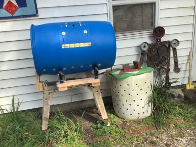

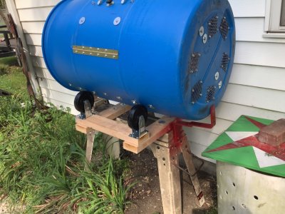

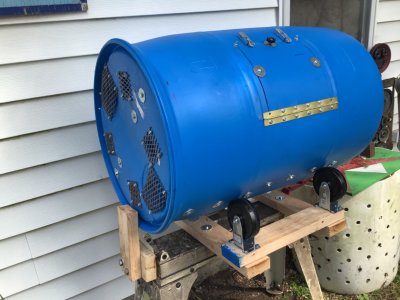

My metal band saw quit on me. I could hear it cutting away like always. Then it kept going slower. Before I could get across the shop to it the magic smoke escaped from the motor!!!.
Saw was purchased in the late eighties. Decided to buy another one. Harbor freight special. Other than color it was practically the same as the old one. Just red instead of white.
Recently acquired a plastic 55 gal barrel for $5. Finished turning it into a composting barrel today and used the old saw base to support it.

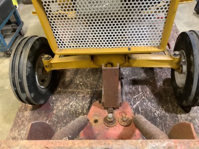

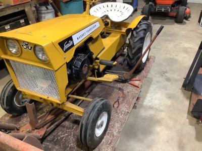

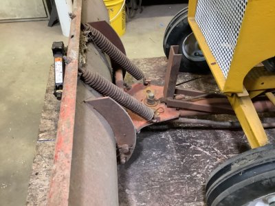

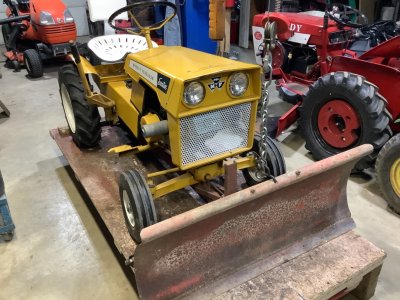

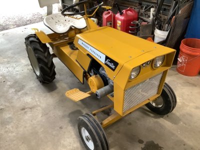

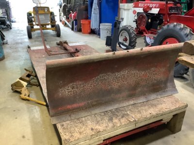

A while back I brought home two old Masse Ferguson garden tractors. They were junk, but the came with a Massey snow blade. This afternoon I started putting it onto my Massey Executive. The blade is designed for the newer and much larger Massey 10, 12, 14 and such. So I knew there would be some figment problems. Plus when I refurbished this tractor I never reinstalled the lift arm. PIA to do solo.

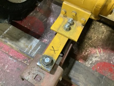

The frame mounts at the rear hitch. I already had an extension on the hitch and bolting to it left good clearance at the front.
Needed to drop the hitch extension to get clearance under the tractor. After mounting the lift arm and positioning the blade it was evident that the arm for changing the blade angle would be in the way of the lift arm. Thankfully it won’t be difficult to swap to the other side. Maybe do that tomorrow.
The yellow plate with the x on it will get replaced with a wider and longer plate that will attach to both holes in the plows bracket.
After I rig the lift linkage I will know if I need to adjust the rear hitch up or down.
Then I will have to figure out the brackets on the front that keeps the blade/framework aligned.

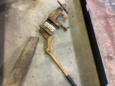

Looks like you have a good plan Rick! I had thought about taking the homemade hydraulic Cub Cadet blade off of my 8E so I could get a blade that could angle from the seat. The biggest issue I thought was where you are at trying to come up with a way to keep the blade centered. They don't have a front bumper to bolt the alignment bracket to and it would also interfere with opening the hood/iron grill assembly to work on the engine.
My lift lever was off the tractor when I got it 30 some years ago and it and had been laying in the dirt outside. A few years ago I broke axle splines trying to pull a hub to put new seals in, so the transaxle had to come out. Freed up the lift lever and put it on thinking that I would build a sleeve hitch. My tractor has the mount for the sleeve hitch but the rest of it was long gone. Nope never got "roundtuit" yet.
I will be watching what you come up with!
