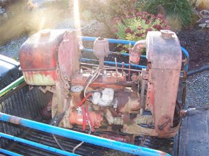

Got a break between rain showers so I went for startup. It teased me for a while with sputters and smoke and then a cough here and there. Finally it came to life and picked up all the cylinders. It was just a short run as there isn't coolant in it yet, but long enough to determine the carb needs some attention. I'll get the carb and coolant addressed and then maybe shoot a short video.

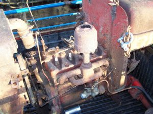

What kind of a muffler is that? It looks pretty heavy duty.
Its all cast iron and fits under the hood and had a tall exhaust pipe on top.. When you look inside it has a couple spiral flutes also made of cast. The outer part has a couple cracks in it probably from rust buildup. I had to vacuum it out before starting it and still got a shower of rust chunks raining down on me. We have a manual for the combine, but I don't know if it has a parts list.
Yep, it sounds pretty good. The longer it ran the more the exhaust cleaned up. Might have been some sticky rings that freed up. I want to run it a few more times and then do a compression check on it.
