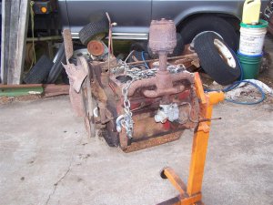

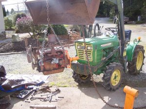

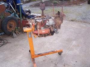

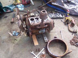

Today I pulled the Some pieces off the power unit so I could mount it up on an engine stand and used the Yanmar to pick it up. The plan is to re-ring it and check the rod and main bearings. We will see if there is anything else needed when it gets opened up.

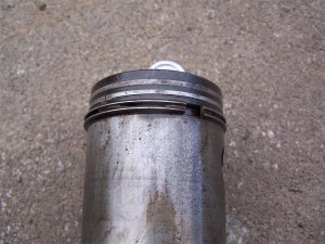

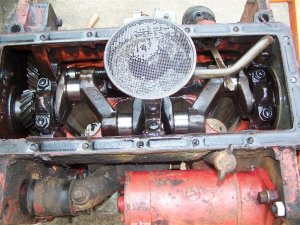

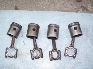

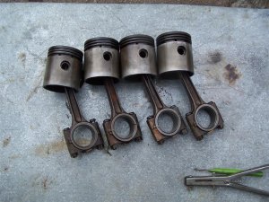

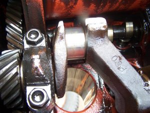

Drained the oil, rolled the engine over, and pulled the pan. It looks pretty clean inside. Then pulled all of the piston/rod assy's. All had stuck top rings, 2 had both compression rings stuck, and 1 had compression and oil rings stuck. Got the micrometer out and the rod journals measure right on the money, no wear.

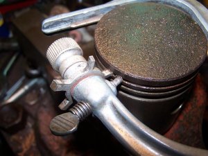

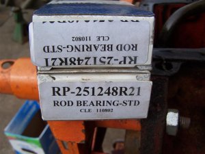

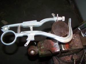

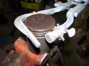

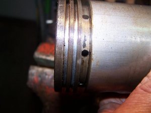

Had to break 3 rings to get them off the pistons, but they are off. Then went on to ring grove cleaning. This is one of Dads tools from his mechanic days. It cleans the rust and crud right out. I found some standard rod bearings in our stack of cub parts along with a couple full gasket sets. I'll get some new rings and a ball hone ordered this week. Hope to be able to put this back together by next weekend.
