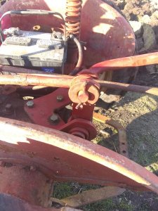

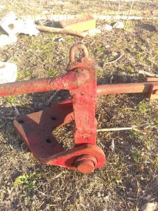

The guy point out what wrong with my lift. The old one was chopped and added too late so I went in the pile of parts and founded a better one.

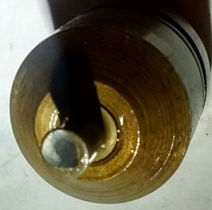

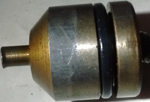

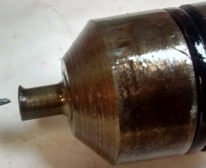

When you're going through the touch control block pay close attention to the pressure regulator valve piston. I believe wear/damage to mine caused the valve to stick open thus no hydraulics. Mine is an early block, and they did change it later.
The stem on the piston pushes a ball in what they call the check valve. Later blocks used a plunger instead of the ball. On mine the ball wore the end of the stem:
That wear was causing the piston to **** (<- that is another word for a male bird, apparently unacceptable here) in the bore, it had wear on one side at the front and the opposite side behind the o-ring:
I suspect maybe it also picked up a piece of grit and stuck in the open position, although I believe it was closed on disassembly. Perhaps it got shook loose in handling.
I repaired by putting a spot of weld on the end and squaring everything up. I also added a healthy divot to the end to try and keep the stem centered on the ball.
Unfortunately it's not back on the tractor yet so I cannot give you a final status.

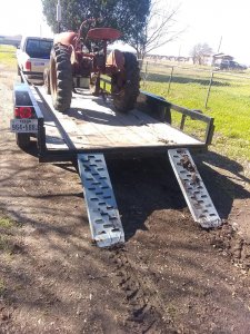

I need new ramps. I got one I just need to make a second one for it. Anyways I got the cub loaded to taken to Temple tomorrow so it can be fixed.
