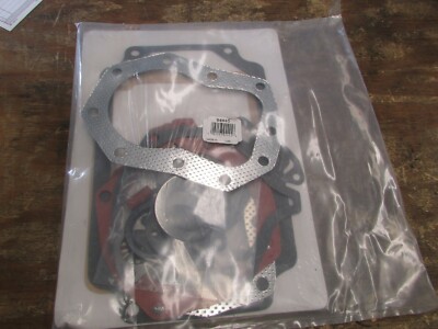

Gary what gasket set are you ordering. I’m repairing a broken governor rod on a K301 and will be ordering a new gasket kit soon. Are you going OEM or after market. So far I can’t justify the difference in price. I’ve talked to a couple of guys that rebuild Kohlers and they are very happy with some of the after market kits. One guy told me a few have the head gasket with no metal ring which is no good to be careful.

Hi Jim I went with an aftermarket gasket set I've good luck with aftermarket parts for Kohlers as to the head gasket I can't say for sure there is one with but the pictures show it in a plastic bag to hard to see for sure looking at the picture again it looks good I maybe wrong but I think the newer engines like the Commands has the fiber head gasket with & without the metal inner ring and I would never install one without the metal ring, have to add I didn't have good luck with same as CS seals for my M20

The head gasket in that link has no ring on it.
