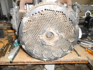

With the retaining ring in hand, I was able to button up the front of the engine! First was getting the rest of the governor on:
Then the front cover and stator:
And the flywheel.
Got the shroud & starter on too!

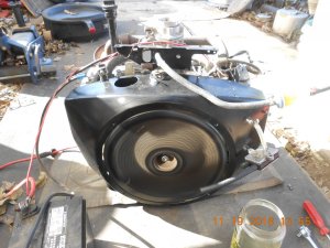

The Onan is ready to start! I'll turn it over for a bit to get the oil flowing, then put the plugs in and get a fuel line going. Depends on the weather when I fire it off. Got mighty cold here too quick!
After I got a fire going in the shop, I piddled with this some more. Put some oil in it and hooked a battery to the starter. Spun it over several times (no plugs yet) to fill the filter and oil passages. Topped off the oil and put the plugs and wires in. It's ready to start, but may be tomorrow or Tuesday. I want it outside so I can let it run for a while! Too cold out there today! Right at freezing right now without the wind chill.
I also painted the flywheel screen yesterday. Want this to look nice as well! Wish I could use the 420 muffler, but I think the frame will not allow that. May have to find a 316-318 muffler.

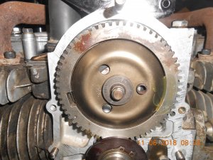

No heat here! I need to get another small puller, split mine in two.
Is there a reason why you won't or can't use heat. I remember I rebuilt an old Volkswagen Bettle engine when I was green but like a sponge. An old timer told me about the freeze & heat method at the time I was amazed. My mom didn't like the ring gear in her oven though, I didnt have a torch.lol
Nothing to heat it with to come off.
