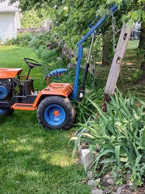

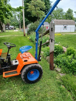

Wfe wants to change some of our fencing.

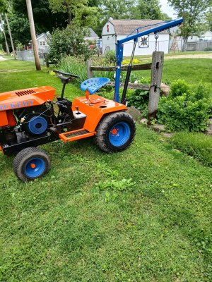

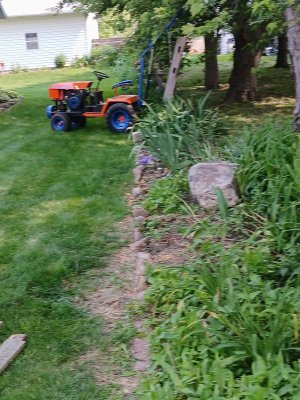

Getting rid of some split rail. Used the Roper to lift sime posts ou of the ground. 90 feet and 10 posts yet to go. No hurry since new fencing is at least 3 weeks out.

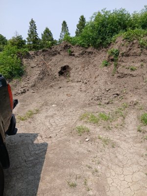

Supposed to be rainy the rest of the week. So I pulled the rest of the posts and rails this morning. Put them on Craigslist and Marketplace. Made two trips to the village lot for dirt. 5_5 gallon buckets each trip.

And you can pull those posts without lifting the front of tractor up ?
Had to have a stubborn one ?
I did have a couple stubborn ones. Most were pulled by hooking the mid point on the arm. One I had to stand on the footboards for extra weight. Another required hooking on to the arm closer to the actuator to get it moving, then rehooking further out to clear the ground. I had to do all of the chain positioning, and ran the control standing next to the tractor. Wasn’t going to get on and off the tractor an more than I had to.
The wife refused to be my “hooker”. :D

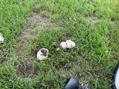

There is some big ugly fungus growing in a small area under the 2 old pine trees!

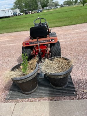

Used the MF1450 And the mobility scooter. Had to haul a couple of flower pots around back of the hose to replace a couple of those fake barrel halves that were rotting away.
Had to get the drag out of the weeds behind the shop.
Loaded them on the drag.
Unloaded them where she wanted and put the tractor in the shop.

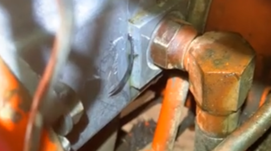

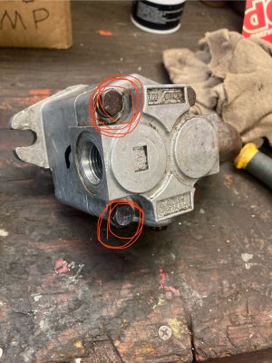

Soooo, I have repaired the Case 224. The leak was coming from the pump. Lucky me, I bought two used pumps from a fella in Ontario back when I first fixed up the Case 224, which needed a pump at that time. So I fitted the other pump on and tractor is now working and driving again. Without any oil leak.
Two bolts were a little loose on one side of the pump. This was enough for it to blow the o ring out between the two half’s of the pump. So if any of you have a Colt, Case or Ingersoll tractor with this style pump, you should check the four bolts holding the pump together.

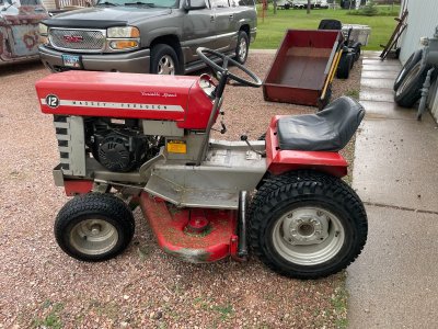

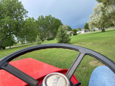

Mowed our yard and the ditch out front with the MF12G today. "They" said there was 0% chance of rain today. Yeah right!
It hadn't started yet in the pic but light rain started shortly after. Kept mowing. Looked like the heavier rain went just to the south with lots of thunder and lightning.
The old tractor got rode hard and put away wet!
