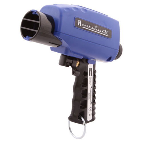

Static electricity in fiberglass made me hate brush lettering racecar bodies made of that stuff, Bill. I would get the lettering brush about an inch from the surface and the paint would suck out of the hairs leaving lightning bolt looking splatters where the paint wasn't supposed to be. Had to spray the back side of the fiberglass with water in a spray bottle to kill the static. Sometimes a person couldn't reach the backside where painting was needed. Had to keep cleaning to a minimum as drying the surface with a clean cloth would generate the static. Sometimes a wire alligator clipped to the panel and grounding to the floor would help. Thank god most of the bodies were steel or aluminum! Even then, a lot of them used fiberglass roofs. Could spray them easily at least.
I see they have Static Neutralizers in the auto painting trade now. Some are really expensive at over $850.
