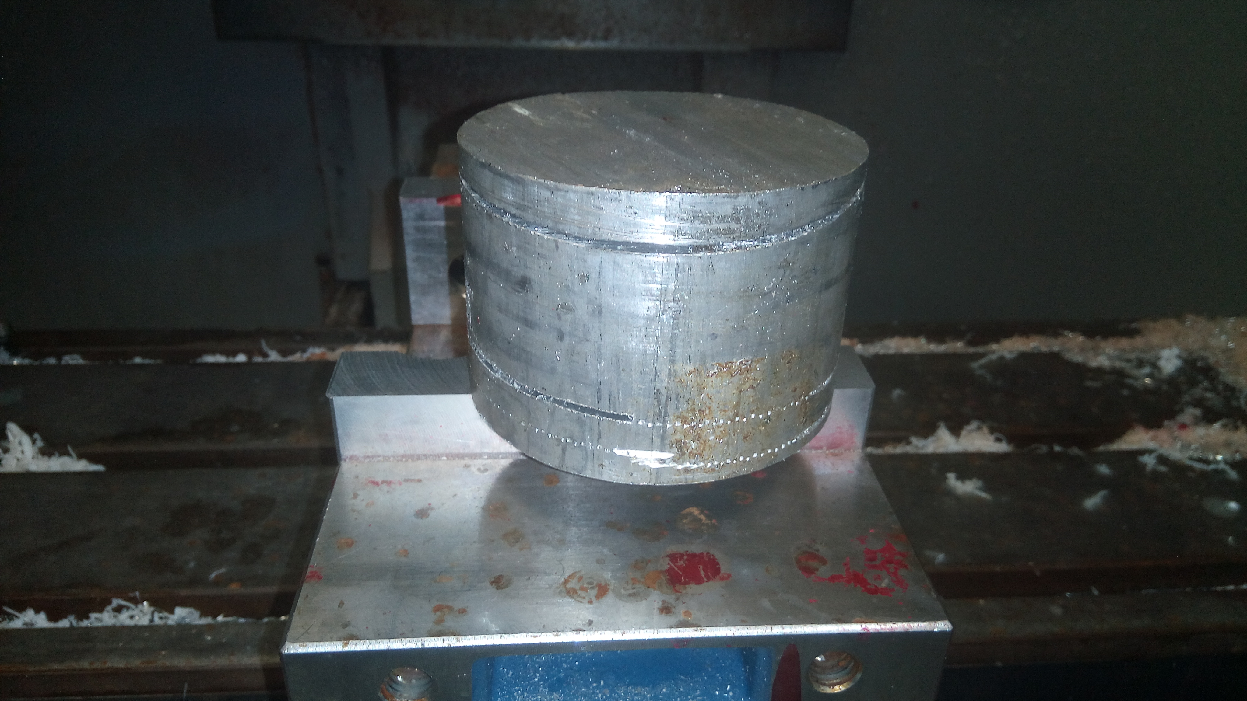

From this:
Raw Stock, 4" 6061-t6, messed up by student learning to run cutoff saw.

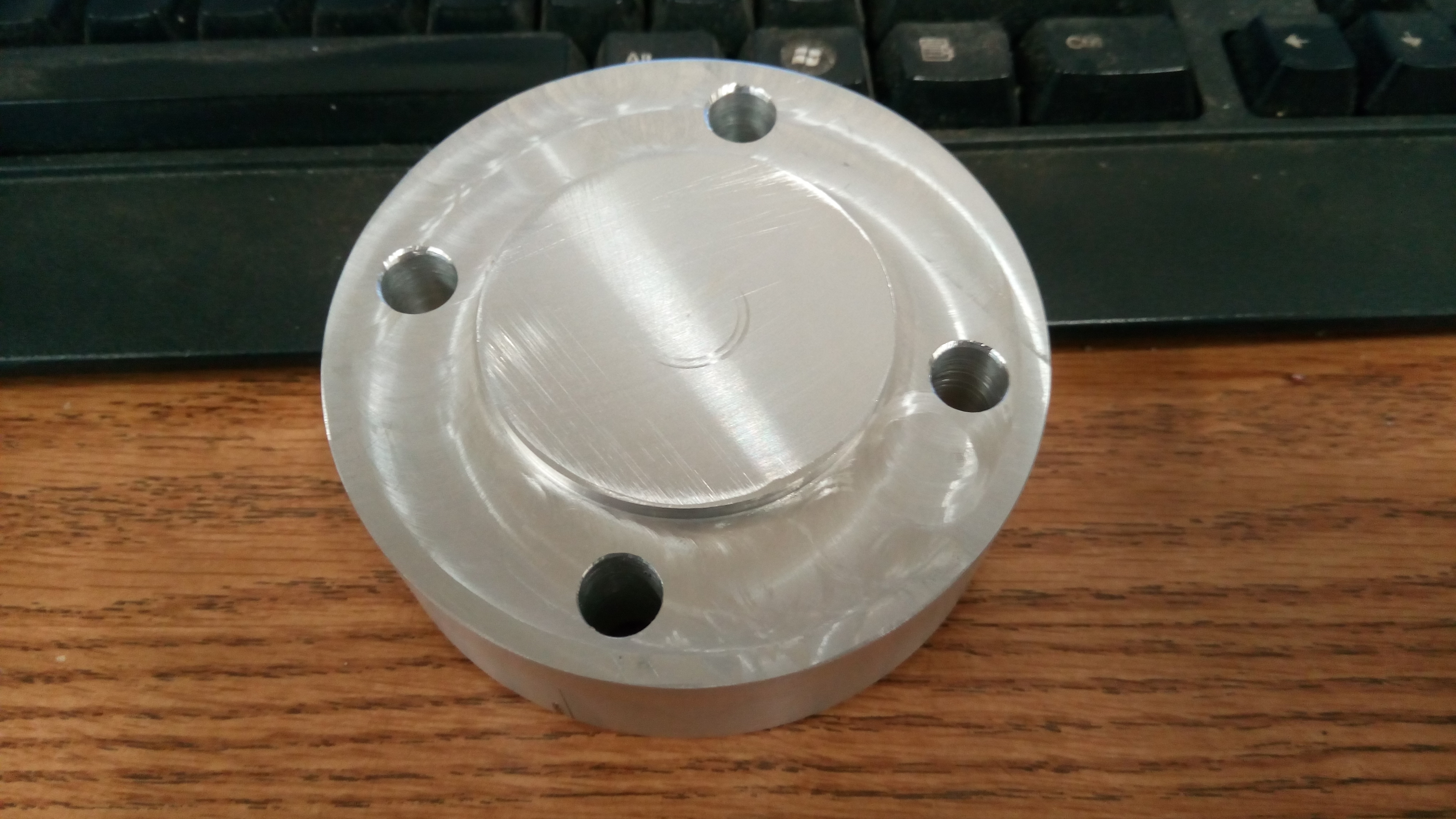

To this:
Going out this afternoon.
