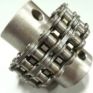

Looks like it would work real well, Chris, but this animal has to be 9" long. Would take quite a bit of fabricating to build that.As far as the Lovejoy goes you could put a sprocket on each shaft and wrap a chain around them. This allows for a little movement but keeps things aligned.

Steering u-joints aren't rated to spin 3,000 rpm plus. I'm sure there are high speed smaller u-joints out there, but that's one more thing to buy, then the splined couplers and invent flanges to make it multi piece for installation. Think I'm better off dealing with this setup. Just going to have to line up the shafts fairly precisely. Still on the fence about spending 150-200 bucks for a couple of 11 spine couplers. What I took off was still working and the shafts on the tractor don't look any worse.Would a small steering U-joint work to replace the Lovejoy?

Thanks for the comment, Rog! Yes a PTO u joint should work fine. I should have thought about that more. Automotive steering column u-joints wouldn't hold up. I have used lots of them on racecars through the years. They aren't built to handle rpms. We used to get them out of junked Toronados and a couple others I don't remember anymore.Using a small u joint will handle the speed. They use them on PTO equipment a lot. I put one between a B&S 18 hp and the hydro that was a close line up and it ran for 2 years before I sold it. Did not spline either shaft either. Just ground a flat for the set screw to lock down onto the shaft.
