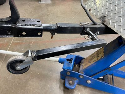

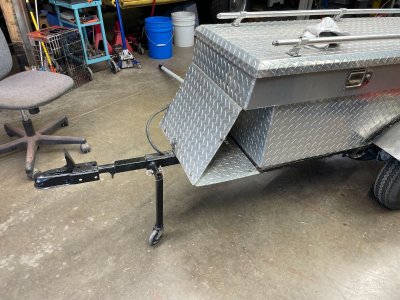

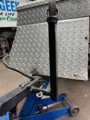

Today since there wasn't a lot of time I did a modification on the freebie tree trimming trailer which used to be pulled behind a motorcycle.

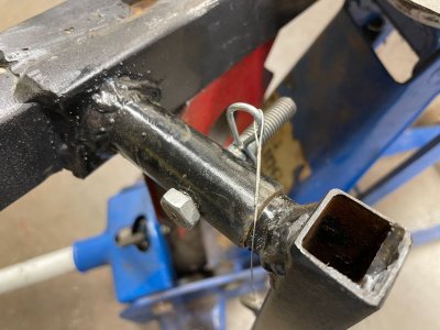

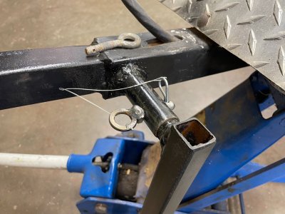

I had built a leg with a castor on it but I didn't do a very good job. It was sloppy when pinned. The pin itself was a dumb idea too using a threaded 5/16" eyebolt. Drilled the holes to 3/8" and built a pin out of a 3/8" bolt.
Welded a big split washer to the head to make a loop. Bent it flat first. Managed to drill the hole through the pin pretty square for once! Cut off the threads and attached the hairpin. That cable is a steel fishing leader.
It will spin 90* and straight up. It will be straight up when pulling though.
