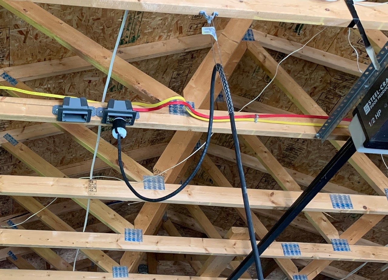

If you think your going to be moving that lift you might want to consider a drop cord from the ceiling. If you do that be sure and use a strain relief on the cord.

I can't do the ceiling mount cord as the overhead door is right where it would need to be for both locations the lift can sit in. I don't mind the wall outlet, just need to get the parts to build a flexible cord too, and probably better build a heavier one coming out of the control on the lift too! That is a 20 amp cord.
