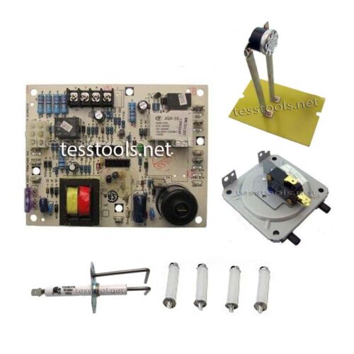

I was able to test the transformer to eliminate that being a problem today. 27.1VAC within the 24 -28 spec. With that eliminated I ordered this kit.
It has a new board, pressure switch, high temp limit switch and an igniter. Mr. Heater website does not list a mother board as available parts but the other parts were. It's all chinese anyway so just gotta hope they are decent parts.
It is what I would call plug and play. Unbolt the board, unscrew 4 wires and pull a couple of plugs. Now I just hope that both of the fan motors are ok. I did get an email back from Mr. Heater company and first thing they wanted checked was that transformer then it was pretty much bad wiring or mother board. My dang hands get cold so fast even at 42*. Temp is hanging on pretty well considering the storm going on outside. No other form of heat out there in the lift bay. Supposed to be 70* Monday, LOL!
