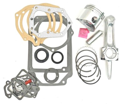

The engine is going to come out of the MF1450. It has leaked all the oil out of it where nothing is showing on the dipstick. I'll get some pics tomorrow of leaking. NOW the "Just as well" part starts. If the engine is coming apart for a full re-seal, it would probably a good idea to give it an overhaul. Will have to get the engine apart to measure the cylinder taper and out of round to see what overbore would be needed, but it seems plenty are available.
There's a lot of kits like this one. Some with valves but no connecting rods. Hopefully they are universal to all K321 engines. My egine is outwardly different than one Noel has, but Jake has one very similar to this one. Main difference is the governor position if I remember right earlier in this thread.

Jumpins, must be quite a leak Doug to empty her. I have had good luck with those kits , but they always had a rod with them. Good luck with it. Show us your progress.

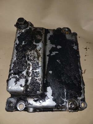

Got the engine pulled. The oil pan is definitely cracked but not where Daniel suspected.
Things look pretty good on the outer of the engine, nowhere near as greased up as I expected. It was hanging crooked but I decided to check the oil before I drained it. Way overfull! Remember when I checked it and nothing showed on the dipstick? I had forgotten to close the shutoff and like someone had said earlier, that plastic chinese pump must leak into the crankcase! It helped me find the leak though.
The crack is visible here if you look close. I started wiping all over the pan I drained probably 3 quarts of thin, gassy smelling "oil"! That left front corner kept getting wet after I would wash it off with brake cleaner. Pulled the pan and cleaned it up.
Going to clean it better, but not sure what to do about it yet. More to come.
