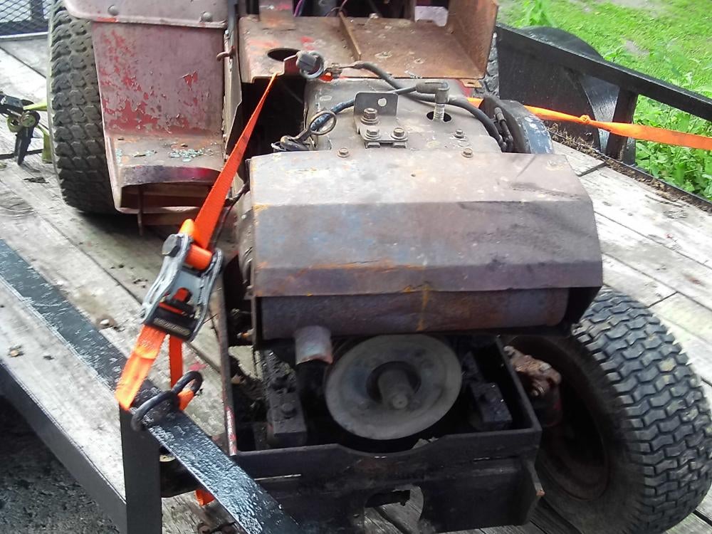

Got a little more done today. The new cables came in yesterday and I was able to make the choke and the throttle cable out of one. Looks like I have an extra 8" cable.
Drilled a hole in the aluminum dash panel for the new choke cable position.
I cut them off a bit long so they will need a little more cutting when the final hookup is made. Also re-routed the starter cable to a position where nothing is rubbing on it. The plate on the steering box was hitting it. That could have been bad.

One thing leads to another. Quite a while back, Daniel sent me this cover for the spool valves. Very hard to find item, I'm sure!
Problem was I couldn't use it because the center lift lever was not original, and I would have had to hack the slot bigger to make it work.
Kenny came to the rescue and is sending the correct lever setup! Tonight I went ahead and removed the knobs, and the incorrect lever and plopped the cover on. STILL WON"T FIT DANG IT! There is an added on bracket to hold on the cover to the center lift piston shaft spring assembly. That cover is broken and this bracket holds it on!
Does anyone know if that cover is aluminum or pot metal? I may stand a chance of welding it if it is aluminum. Might have to try JB Weld? That will be touchy since it's at a flange that has screws holding it to the valve body.
If you guys recall, near the beginning of this long, drawn out thread, I mentioned that I think this tractor fell out of a pickup or off a trailer at one time. More evidence of that kind of damage right here. The fender is bent down too but that won't be a problem to bend back up.
Any ideas out there? I would think that cover is harder to find than the plastic parts for this tractor.

That's the detent cap for the float spool, right? I'd probably use epoxy to put it back together, myself....
Yes, Sarge, for the float spool. The center lift has the float, and the 3 point does not. The float is built into the 3 point mechanically. I looked inside it and it looks like the end of the spool rod is hitting the inside of the cap. Will do some more checking tomorrow night.
