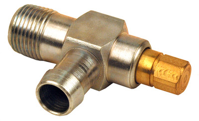

Thanks for that link, Adam! I think I'll order a couple of them! Probably put one on that MF8E and maybe this thing if I ever need to lift the engine!Try one of these, just add a piece of hose when changing oil.
VALVE OIL DRAIN 3/8-18 MPTF (12260) | eBay
Find many great new & used options and get the best deals for VALVE OIL DRAIN 3/8-18 MPTF (12260) at the best online prices at eBay! Free shipping for many products!www.ebay.com
