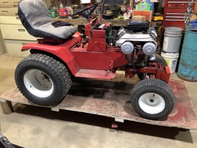

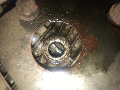

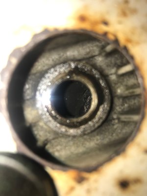

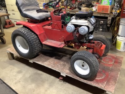

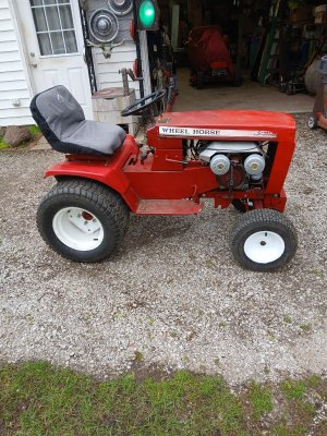

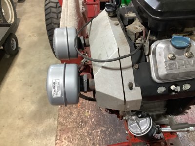

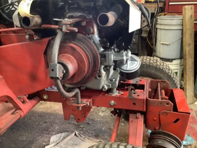

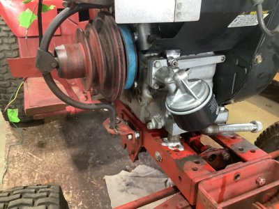

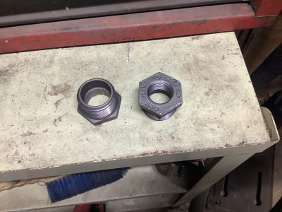

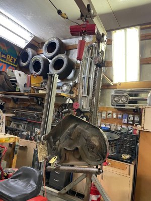

I have a Wheel Horse C141. Been fussing with it off and on for awhile. The 14 hp Kohler is worn out.

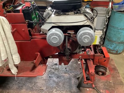

Decided to replace it with a Briggs 18hp v twin. Engine swap has gone fairly easy. Was pleasantly surprised to have the hood fit over the twin. Before removing the Kohler I took several measurements off the centerline of the crankshaft and the clutch disc.

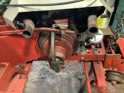

Managed to get the Briggs into the same position. Needed a 1” to 1 1/8” adapter sleeve to fit the clutch assembly onto the Briggs. Everything else fit right up.
Tomorrow I will replace the ignition switch and wiring. Reroute the oil drain. Hook up fuel line,
The oil filter and housing on this particular engine hangs to the outside of the engine. Right in the way of the belt routing to the mule drive. I found a new housing that moves the filter to the opposite direction. It will be here in a few days. Then with a new filter and oil I should have a runner.
