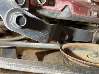

Now reaching the side adjusters is where this gets really ridiculous. I will be drawing blood doing that for sure! Two views of the right adjuster.
And a couple views of the left one.
It is possible the link with the "LH" on it is bent. This thing used to mow level when I first revived this tractor from freebie junk. It is mounted so rigidly to the tractor that there is no forgiveness at all when the operator hits something and it is generally the left front deck wheel that hits something. The height difference between deck raised and lowered is only a couple inches.
