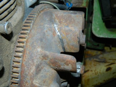

You might want to take the flywheel off and do what ever to fix it. Why I say that is the jarring and vibration may loosen the magnets inside. That would not be good.
Still thinking of a fix yet for the broken off piece.

Another option would be to drill a row of small holes across the fin where you want it to break off. I don’t know if you can get at that part of the fin though.

I thought I had that flywheel thing figured out. I found an allen head 3/8" bolt and nylock weighed .9 oz. One tenth more than the broken off piece. I figured with the hole drilled in the flywheel that .1 oz heavier would be about right to make up for the hole.
Got it marked out and center punched.
It drilled out nicely working my way up to 3/8" in 3 steps.
Put some Loctite on it and tightened it up. Overdid it and it broke again! I didn't consider the curve of the fin being a weak spot.
Time to dig out the old Dremel with a cutoff wheel. The opposite fin is now going to die!
Shaped it as close to the opposite side as I could. Just going to have to live with it now. Maybe someday I will run across a good flywheel if this thing runs.

Sorry that you went through all the trouble Doug that I mentioned. I really feel bad and I’m sorry that I didn’t mention the curve in the fin. I felt like you were getting enough suggestions and one more of mine would be too much. I think you’ll be good now that you got them trimmed down evenly on opposite sides.
Not your fault, Jim! It was a good idea! I'm the dumass that thought it had to be gorilla tight!
