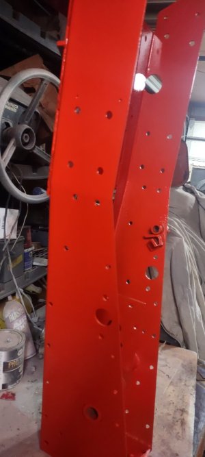

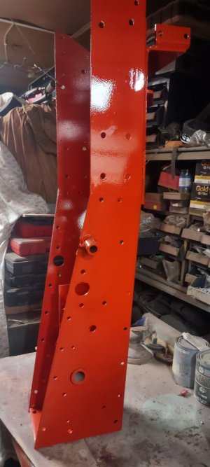

I did get the front main frame primed tonight, tomorrow it will be sanded. If the sanding doesn't take too long I should have it painted tomorrow night.

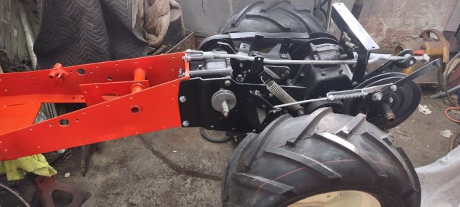

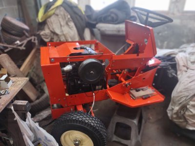

I did get the front frame bolted to the back last night.IMG_20250821_183244185.jpgIt was a pain to get the 8 bolts lined up. 4 on the sides and 4 on the inside which bolts to the 90 degree gearbox. I put the rear tires on also, my back today has reminded me what I did on the tractor yesterday.

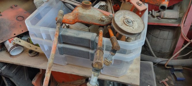

I sandblasted most of the front axle parts today (front axle, steering tie rods, and plate the tie rods bolt on) and sprayed them with primer. I plan to sand on them tomorrow and then spray them orange tomorrow. The one tie rod from the steering box to the plate is 1/2 ground down from rubbing on something. I hope once I get it installed I can see what and why it is ground down. The tie rods are 1/2" diameter on this tractor.

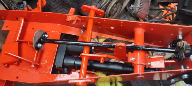

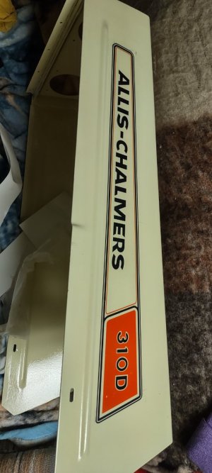

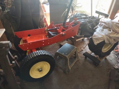

More progress yesterday, I finished up the front tires and wheels. The new tie rod end came in, finished hooking up the steering. The rod from the steering column to front looks to run on the bracket for the electric lift. I will end up replacing the whole shaft. There have been a couple of times of removing a part to be able to install a different part, joys of working on a different brand. IMG_20250902_124101773_PORTRAIT.jpgIMG_20250902_145920548_PORTRAIT.jpgI did find a run on the hood in the clear coat I need to take out before the decals go on.

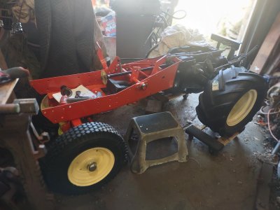

The foot steps are on a long with one of the side panels. Still working on the grill, it has a lot of small dents and twists in the bottom metal. I am to the point of having to make 4 of the panels due being rusted out and parts missing.IMG_20250907_141344132_HDR.jpg

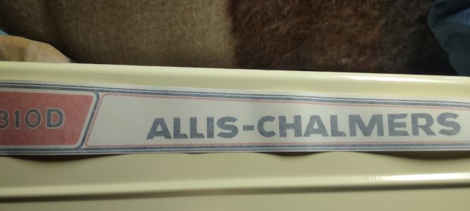

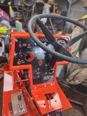

I looked all over trying to find a dash decal but was not able to find one exactly like this one. I found one for a hydro that was close. I ended up masking it off sprayed the orange and then put clear over the orange and decal.IMG_20250914_114208745_PORTRAIT.jpgOther than the bottom right corner it turned out pretty good.

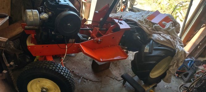

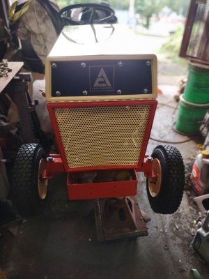

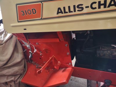

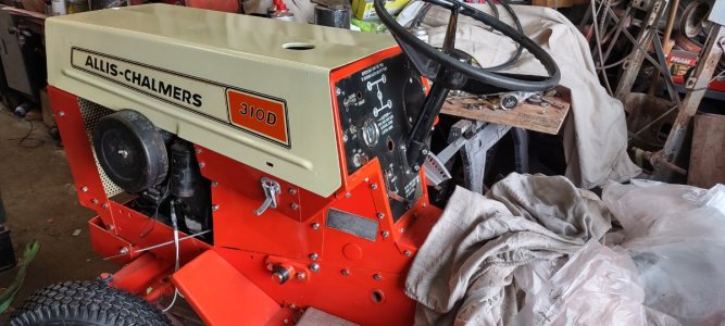

It has been a long couple of days working on this tractor. It is not looking like it will be done before Saturday for the local tractor show. I still need to paint the rear fender piece (tomorrow) and finish up the wiring. I also found out I need to treat the gas tank with a rust remover. Some pictures of the progress IMG_20250918_161559083_HDR.jpgIMG_20250918_161657187_PORTRAIT.jpgThe hood was not easy to put on, originally it was riveted and I used 1/4 screws that just barely fit. Rivets would have been a lot easier.
